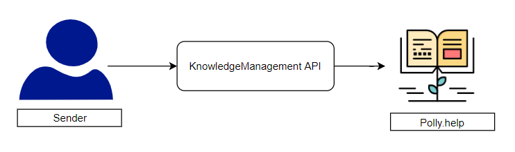

Conceptual model

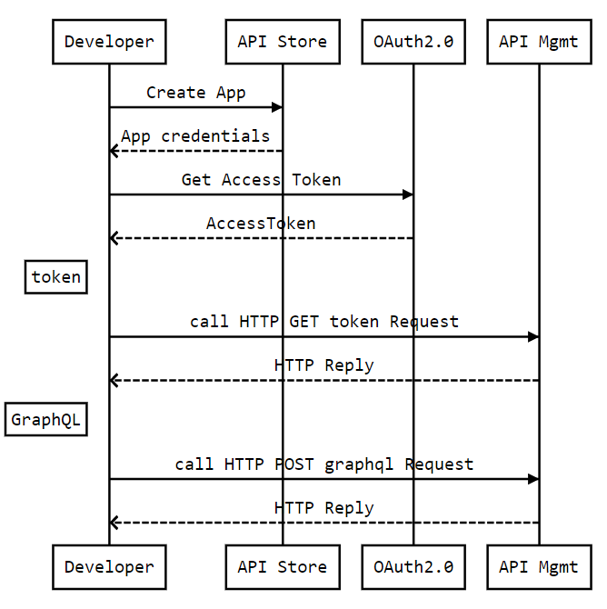

API workflow

Getting started
Make sure you've read What's in it for you for more info on how to register and start testing APIs.
Authentication
The API follows the KPN Store API Authentication Standard to secure the API. It includes the use of OAuth 2.0 client_id and client_secret to receive an access token.
Go to the Authentication tab on top of this page to find out how to:
- Authenticate to an API using cURL.
- Authenticate to an API on Swaggerhub.
- Import Open API Specifications (OAS), also called Swagger files into Postman.
Setting up your third-party account with Polly.help
When you add this Knowledge Management API to your project in the My Developer Portal, you will receive an e-mail at the e-mail address that you registered. The e-mail will provide you with your password to log into the Polly.help website. Go to the Polly.help login page and log in with your e-mail address and provided password.
Once logged in, you can create a knowledge base. Select the appropriate template from the list of templates for the type of knowledge base you would like to create. For example: Demo Retail NL, which provides you with default collections, articles and more, written in Dutch.
With collections and articles in place, you can create a publication. Add collections to the publications and publish one or more articles.
How to...
Get token information
This request returns one or more tokens of your published information. Use token id and polly.help token in the POST /graphql request.
SwaggerHub:
- Select GET /token.
- Click Try it out.
- Check the response code and message.
Postman:
- Select GET (GetToken).
- Click Send.
Get query information
This is a powerful request that allows you to fire a graphQL query on the knowledge base.
For each request you will need to provide id and token, that were previously retrieved by the GET /token request.
SwaggerHub:
- Select POST /graphql.
- Supply query, token and publication id in the payload. See below for examples.
- Click Try it out.
Postman:
- In the Postman collection, there are different payload based requests available, based on a query using same endpoint POST /graphql. See below for the queries.
- Supply query, token, publication id in the payload.
- Click Send.
