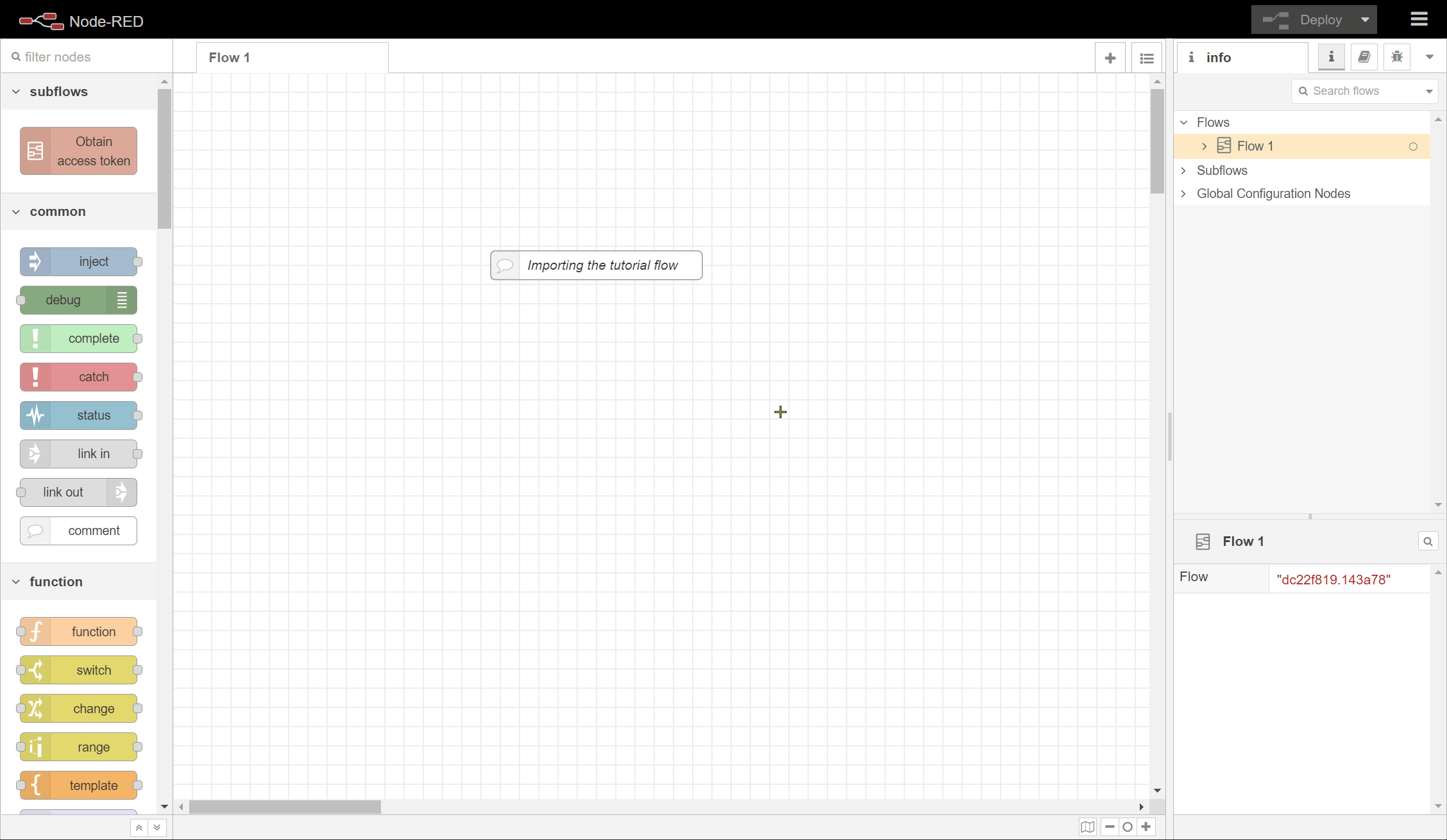

5. Import the tutorial flow {#import-flow-locally}
Node-RED makes it easy to save, share and move flows between computers using the export and import features. Import a flow by using the Import nodes dialog.
  1. Download the tutorial flow JSON code: Download from GitHub: Tutorial_WeSeeDo-Direct_with_Node-RED_flows.json.
  2. Right-click on the file and select Save link as.
  3. Save the file on your machine.
  4. In the Node-RED editor, click on the menu and select Import.
  5. Click Select file to import.
  6. Select the file you have downloaded from GitHub and click Open.
  7. Click Import.
The imported flow is visible in a new tab called WeeSeeDo Direct v1. You can now go to the step 'Send API requests'.

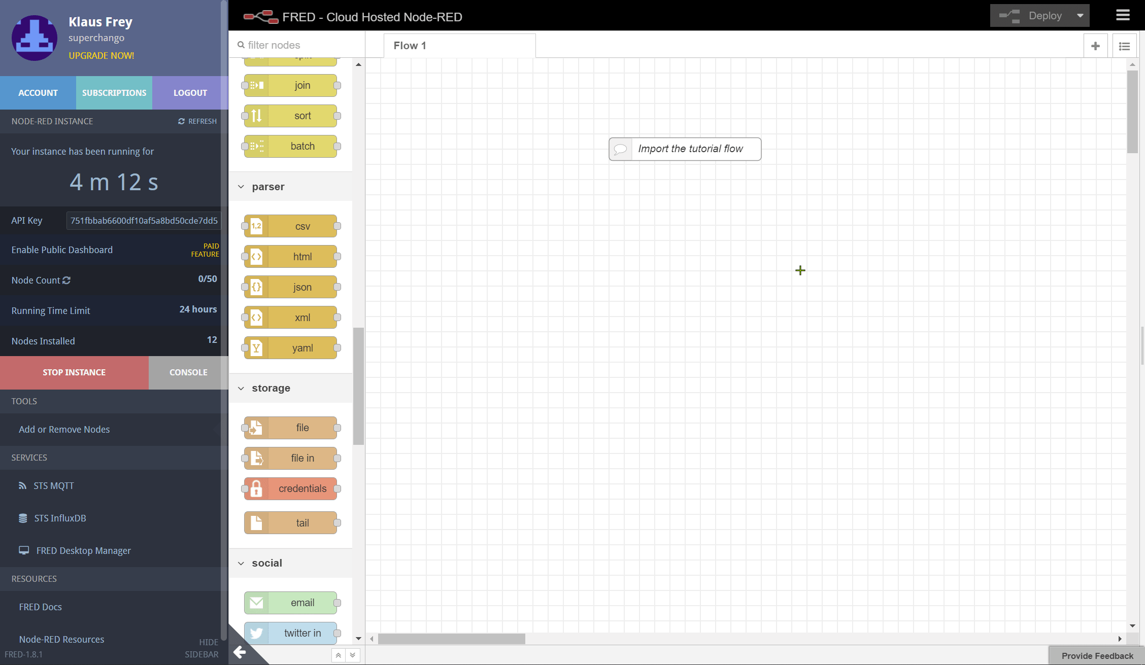

2. Install the credentials node {#import-cred-cloud}
  • Once you have your cloud Node-RED editor open, go to the Tools menu on the left.
  • Select Add or Remove Nodes.
  • In the field Search nodes search for Credentials.
  • When you have found it, click Install.
  • After the node has been installed, click Restart Instance.
Now you can import the tutorial flow (see the next step below).

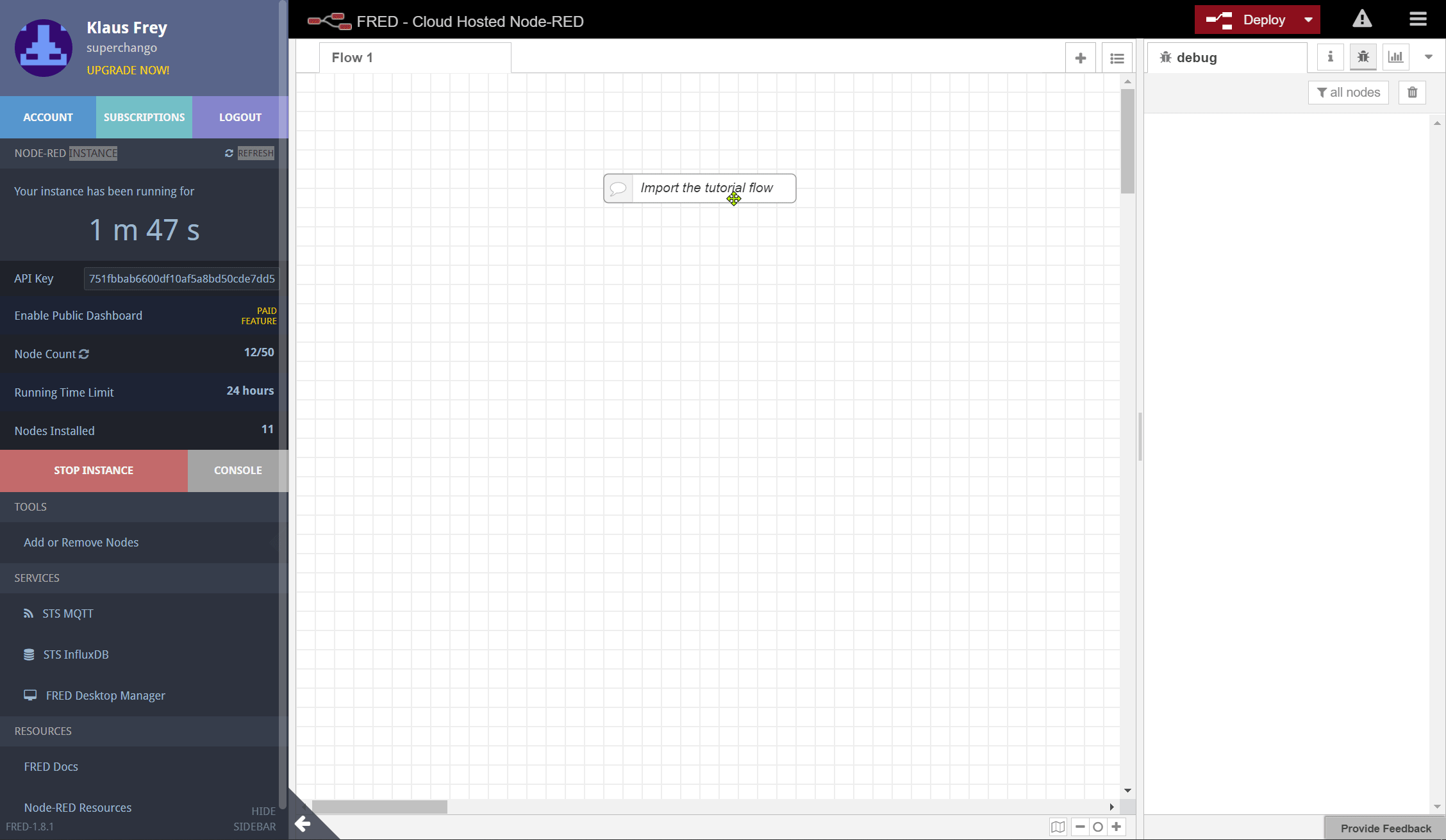

3. Import the tutorial flow {#import-flow-cloud}
Node-RED makes it easy to save, share and move flows between computers using the export and import feature. You can import a flow by using the Import nodes dialog.
  4. In the Node-RED editor, click on the menu on the right and select Import.
  7. Click Import.
The imported flow is visible in a new tab called WeeSeeDo Direct v1. You can now go to the step 'send API requests'.

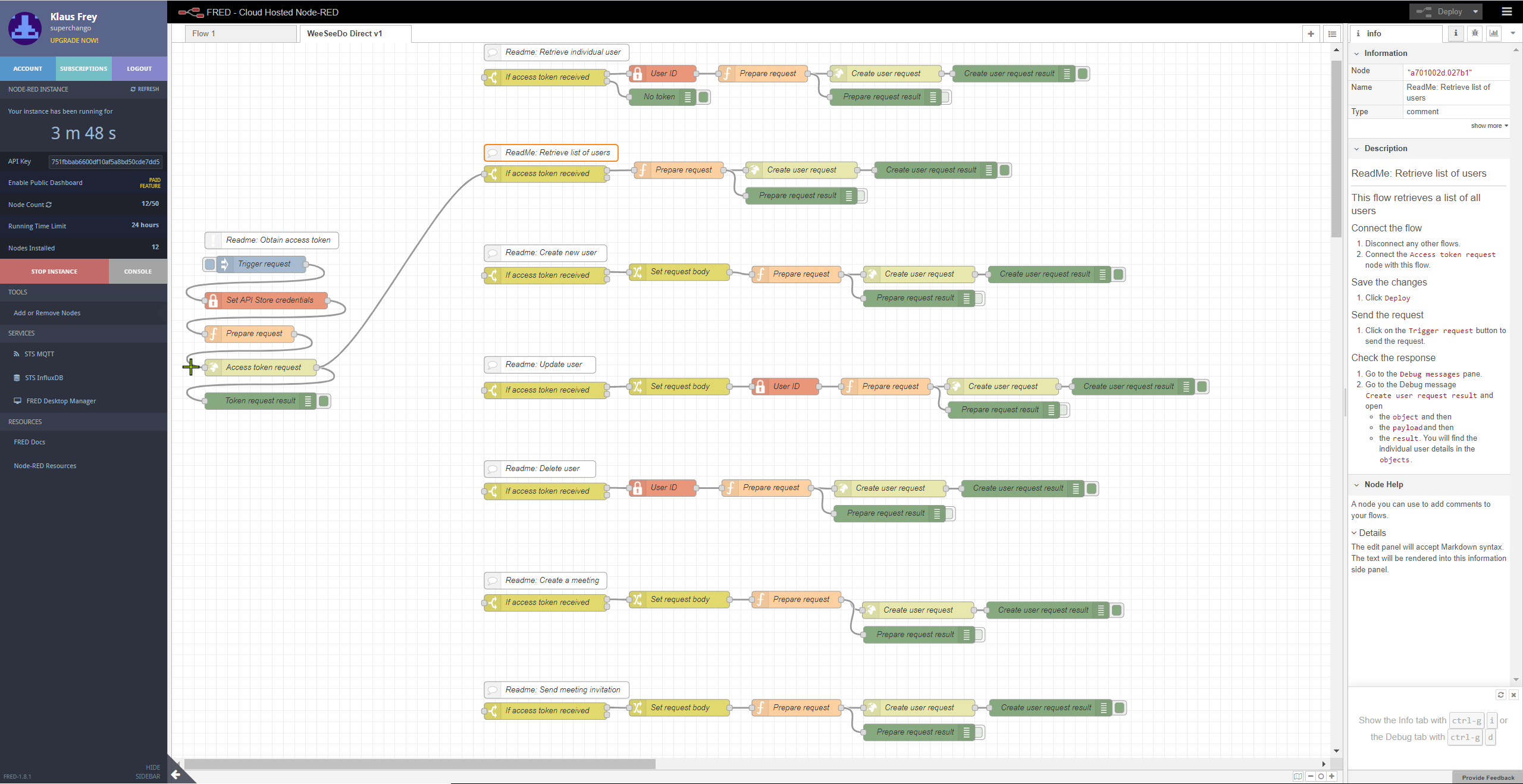

The tutorial flow appears in a new tab. As you can see, the flow is divided into sections:
  • The first flow on the left obtains the access token from the KPN Developer Portal by invoking an Authorization API using a POST method.
  • The other flows on the right are the actual WeSeeDo requests.
Tutorial flow with WeSeeDo endpoints
Tutorials-WeSeeDo-Direct using Node-RED-overview-remote

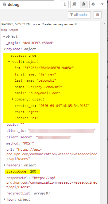

  10. Trigger the API request by clicking on the blue button on the Trigger request node.
  11. Check the response in the Debug messages pane.
JSON example
{ "first_name": "Jeffrey", "last_name": "Lebowski", "password": "bowling.1234", "role": "CFO", "email": "dude@email.com", "locale": "nl", "company": "Coen Bros Ltd" }
Success message
Tutorial-WeSeeDo-Direct Create user Success message

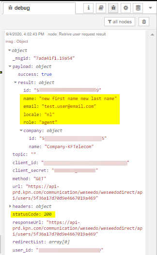

  6. Trigger the API request by clicking on the blue button on the Trigger request node.
  7. Check the response in the Debug messages pane.
Tutorial-WeSeeDo-Direct Success message
